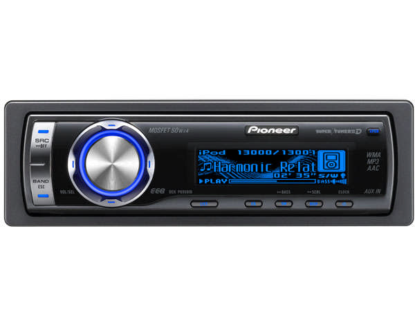

New member Username: BabolimpPost Number: 6 Registered: Apr-07 | after all this discussion i hate to go back on what i originally said, but i've decided to change the HU and put off getting the Sub and mono amp. main reasons being the quality going downhill with every option i choose on the old HU, and 2nd reason being that i wouldn't mind some of the extra functionality and looks of a new HU. i've decided on the panasonic DEH-P6950IB head unit. it has 4V on 3 RCA preouts with ipod direct control *drool* http://www.pioneer.com.au/products/car_entertainment/CD_Tuners/DEHP6950IB/index.html |

New member Username: BabolimpPost Number: 7 Registered: Apr-07 | the thing is buddy, i'm in australia i'll need a unit that is suited for our radio frequencies ie a unit build for australian standards. all the mid-high end units for our market (pioneer range) have 4V preouts... even the most expensive is the same. i'm not entirely sure why, as i've noticed the upper end kenwoods feature 5V preouts. in any event, i feel that 4V is "good enough", considering it's the ONLY letdown i can see for this HU. pricewise? i'll be sniping one of them on ebay for around $250-90AU pickup. thats about $210-40US, alot better than $335US~ my budget? i'd like to get away with < $280AU, 300 absolute max. |

New member Username: BabolimpPost Number: 8 Registered: Apr-07 | when i was in store, the sales guy said that pioneer used to have 6.6V on their top line stuff (i think..? maybe he was talking about kenwood though i forget). however, too many were sent back due to people's amps melting. i guess the australian sector decided to cover their @sses and lower the preout voltage. according to him, the highest available preout voltage for the australian market is now only 5V. so i'll stick with the 6950 :D |
Silver Member Username: OlegSanta Monica, CA USA Post Number: 965 Registered: Nov-04 | amps were melting b/c gains on the amps weren't set correctly. the higher the pre-out voltage, the lower the gain has to be set. all those newbies were setting them too high, overdriving the output stage of the amp - bam, too hot! but 4V is good, you won't notice a difference going to 5V |
