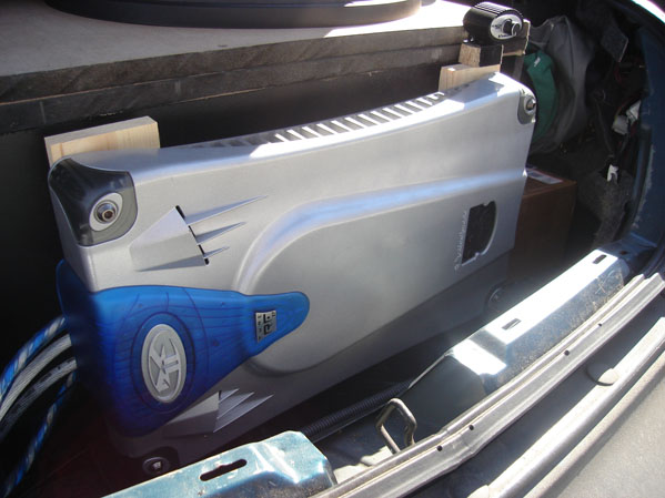

Thanks man. Is there anyway I get get in touch with Logan? Also I really don't have any other place to mount an amp, I'm trying to set up a trunk display.

you could do what i did and just make a small rack right by the box. its basically just an "L" shape. even looks like its mounted on the box...

that looks more than a L shape, How would you go about building a rack and moutning it to trunk?

its just a 2x4 on bottom with the two pieces you see on each side screwed into it. mine looks kinda ghetto lol but it works. made that in like 10 min...

oh by the way, its not mounted at all, just sittin there. its actually dual purpose, keeps my box from sliding during acceleration

lol...very nice definently ghetto rigged j/k its a nice setup Just out of cuiosity why not use velcrow to hold the box in place?

how do you get it to stay there if its not mounted

my guss is the box is holding it in place...and it doesnt look like it has much roomto move around anyhow

Here's a better question, how do you get your box from sliding forward when you stop? That is going to be my problem because I make alot of sudden stops lol.

^^^correct. during acceleration my box moves back, pushing the rack against the back of my trunk. theres probably about 2" for it to move forward, and i rarely stop quickly, so thats fine. its self sufficient standing up too, doesn't topple over. is the only place i could really put the amp actually...
don't know why i didn't bother with velcrow. might have a hard time sticking to carpet... oh well, what i have works fine :-)
