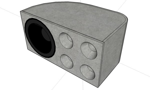

Username: Safe_cracker
Chicago, IL US
Post Number: 2364
Not a sphere either but much better than a cube. the finished version will use a flared slot with curves rather than turns and the port will be made out of fiberglass/resin.. Polo.. :-)
