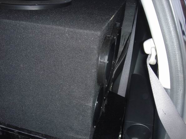

Gold Member Username: BestmankindFi Audio BTL Post Number: 8710 Registered: Oct-05 | ![]() |

Gold Member Username: WingmanaliveNj US Post Number: 2557 Registered: Jun-06 | Looks like you needed a shoehorn to get it in. Do you have any problems with the disc changer that close to the box?? J/W. Sweeeet.![]() |
Gold Member Username: BestmankindFi Audio BTL Post Number: 8713 Registered: Oct-05 | i hope so. i'll tell you one thing though. its way louder than the previous box. i am not saying phil's box was bad cause the idea was mine. i should of told him to build me one with the subs up and port to the side. it is much much much louder like this. by ear it is a big difference. i mean big difference. i only hope it makes a big difference on the tl as well. |
Gold Member Username: BestmankindFi Audio BTL Post Number: 8714 Registered: Oct-05 | normal music the changer don't skip. with bass songs it does so i have to play the bass songs from the hu. |

Gold Member Username: SouthernrebelMonroe, Louisiana DD 9515d~~]... Post Number: 4004 Registered: Mar-04 | looking good man. what are the deminsions/tuning on that box? ps...next time, wall that bish off ![]() |
Gold Member Username: BestmankindFi Audio BTL Post Number: 8718 Registered: Oct-05 | it is tuned to 40hz. i think the tuning might of gone up a little more cause of the resin. 6.7 cuft net. i was gonna plug one port to lower the tuning for daily but it sounds good the way it is so i left it alone. that is a big maybe on the wall. |
Gold Member Username: BestmankindFi Audio BTL Post Number: 8720 Registered: Oct-05 | btw the dimesions are..... width---------------40 inches top depth-----------28 inches bottom depth--------18 inches height--------------17.25 inches that gives me roughly 7.5 cuft before any displacement. i know since its a trapezoid shape there will be a sharp corner. i tilted the box on that corner and poured resin in there. when the resin got hard, i tilted in a different angle to make it smoother. so it got rid of the sharp corners. i did that to all the corners so that box doesn't have a single 90 degree corner. |

Gold Member Username: Logan__tille[:-]15 RE XXX[:-] Post Number: 4249 Registered: Feb-06 | Arent the ports kinda muffled being that close to the pannel?? Looks very very good though. Make a flexing vid![]() |
Gold Member Username: BestmankindFi Audio BTL Post Number: 8737 Registered: Oct-05 | no they are not muffled. i will make the vid this weekend. |
