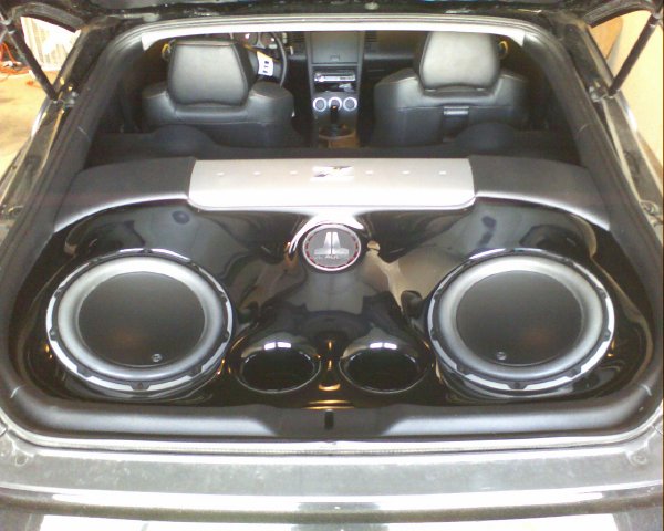

Silver Member Username: Mr_keboAlbertville, Al USA Post Number: 853 Registered: Nov-04 | Well ive decided to try and build a box out of mdf for my trunk instead of the fiberglass route. I was gonna have a guy do the fiberglass but I think i can get it done with MDF. It will just be shaped odd. The box will need to be shaped like a T. Ive included a picture to try and show you what i have to work with. My MAX depth i can do is 14" i didnt include that in the pic. Could someone take a looke at what i have to work with he help me design a box for 1 15" BTL. Looking for 4.0cuft@35hz or so. Any help would be appreciated guys. Thanks ![]() |
Gold Member Username: StnorrisDavenport, IA US Post Number: 1817 Registered: Apr-06 | with those dimensions ur not gunna get 4 cuft net. my box is 37.5 wide x 16 high x 17 deep external and that box is gunna be like 1 cuft smaller. and thats not counting sub displace or port displace |
Silver Member Username: Mr_keboAlbertville, Al USA Post Number: 854 Registered: Nov-04 | 3.955+2.002=5.957 is what i come up with gross if i got 14" tall. what do you come up with? |
Silver Member Username: Mr_keboAlbertville, Al USA Post Number: 855 Registered: Nov-04 | what i did was just cut the box where it "T"s off and figured each chanber seperat and just added them together. |
Gold Member Username: FrkkevinResonant Engineering..., Fort Worth... Email Post Number: 1812 Registered: Nov-05 | That is what I got.. but you never mentioned what size ports.. for two ports 10x3 then would have to be 27.84inches long to tune to 35hz... I'd suggest just running 1 port and loose the eye candy two 8x3 ports would have to be 17 inches long |
Silver Member Username: Mr_keboAlbertville, Al USA Post Number: 857 Registered: Nov-04 | i dont know the port sizes i dont know what would be the best. Im a noob box builder. lol |
Silver Member Username: Mr_keboAlbertville, Al USA Post Number: 858 Registered: Nov-04 | what i could do for the port is use the far left wall of the encloure to do my port make it 15x4 to give me 60sq in of port.How long would that need to be? |
Silver Member Username: Mr_keboAlbertville, Al USA Post Number: 859 Registered: Nov-04 | also where would you guys recommend that i brace this? |
Gold Member Username: FrkkevinResonant Engineering..., Fort Worth... Email Post Number: 1813 Registered: Nov-05 | 14.5x3.25x15.88 - 62 square inches going buy your picure.. O = Subwoofer.. ' = Brace .o. <--- .. one of each side of the sub.. mostly where there is a lot of open space and has no baffle/wall near it for support.. of course not as close shown by the ghetto pic but you get the idea |
Silver Member Username: Mr_keboAlbertville, Al USA Post Number: 860 Registered: Nov-04 | well i kept diggin on my trunk and taking stuff out and i can fit a box that is LxWxH 32x27x14 which equals 5.63 gross. Its ugly in the trunk now but thats ok with me cause after the box is done i will have the guy thats gonna do my fiberglass make it look good like this trunk. Now with this who can help me with the port that i would need and such. want it tuned to 35hz with 16Sqin of port per cube |
