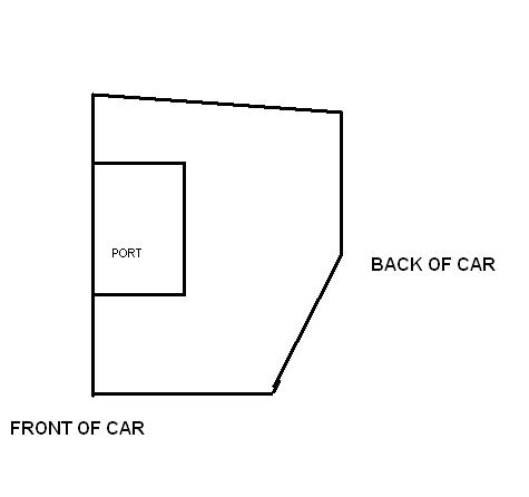

Gold Member Username: BestmankindFi AudioBTL Post Number: 7379 Registered: Oct-05 | some good points there charlie. thanks. which style should i do? pic is not to scale. ![]() |

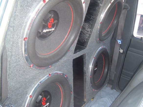

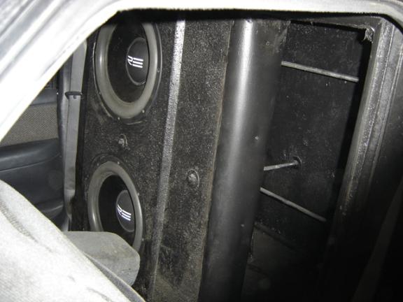

Gold Member Username: BestmankindFi AudioBTL Post Number: 7380 Registered: Oct-05 | thanks canaan. now which way out of the four pics should i do? |
Gold Member Username: B101DD, RE, FI, TREO, KICKERUSA Post Number: 4006 Registered: Sep-05 | B!!! ![]() |
Gold Member Username: BestmankindFi AudioBTL Post Number: 7382 Registered: Oct-05 | yeah i was thinking the same thing B but i have a problem. i can only do 30 inches max height. my subs are 15s. wouldn't it be a bit crowded? will it sound good for daily also if i tune low? like 36hz? |
Gold Member Username: RedlinerWilmington, Ma Post Number: 3120 Registered: Jun-05 | as marshall said stagger them if u have to so put one in the lower left corner and then put the top one a little to the right if u cant stack them straight. yea it should still sound good but if ur going for a wall i would say sacrifice the sq and tune a little higher like 40 |
Gold Member Username: BestmankindFi AudioBTL Post Number: 7383 Registered: Oct-05 | well plenty of wall setup tuned low that sounds good charlie. i doubt i will tune that high cause i want to maintain some sq. i don't want a straight spl car. |
Gold Member Username: SouthernrebelMonroe, Louisiana DD 9515d~~]... Post Number: 3883 Registered: Mar-04 | do option B. use masking tape and expanding foam to fill the gaps around the box. 'daily' and 'wall' really dont go togther, but 40hz would be ok. when you wall the car, it is prolly going to want to peak at a much higher note than it would want to w/ a box in the trunk. you may want to build the port so you can block part of it off and retune lower for daily driving |

Gold Member Username: BestmankindFi AudioBTL Post Number: 7387 Registered: Oct-05 | "10cuft net and you could make the port 20"x8" and ~16" deep. " if that is the case then the port wouldn't have to bend cause the depth is around 38 inches. i can just make a plug for the port so it would tune lower for daily. i can't wait til i get started. actually i can't wait til it gets done. it will be one loud azz mofo. lol. lots of progress pics for you guys. |

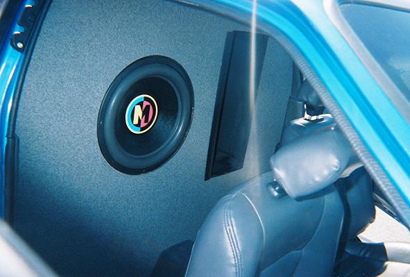

Gold Member Username: BestmankindFi AudioBTL Post Number: 7408 Registered: Oct-05 | ok ok ok. interchangable it is. i will dedicate my wall to you charlie. lol. i will make 4 ports consisting of 32hz, 36hz, 40hz, and 44hz. i might make a 50hz port also cause my car peaks at 51hz right now and with the wall it will peak higher. ima go tint my windows this week so i can get start on it next week. |

Gold Member Username: BestmankindFi AudioBTL Post Number: 7414 Registered: Oct-05 | ok rob. you see the diagram of my car above. what kinda box can i do to increase spl? it can't go in the trunk cause it won't fit. |

Gold Member Username: BestmankindFi AudioBTL Post Number: 7422 Registered: Oct-05 | i like that wall with the mojo. it looks clean. ima cover mine up with black vinyl so it matches my car seats. |

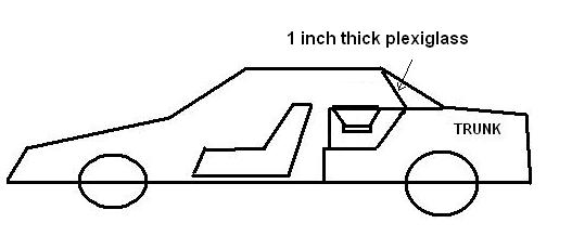

Gold Member Username: BestmankindFi AudioBTL Post Number: 7434 Registered: Oct-05 | here is how my wall would look from the side. ![]() |
Gold Member Username: BestmankindFi AudioBTL Post Number: 7435 Registered: Oct-05 | if i was to keep the same box desing, i was thinking of putting a plexiglass like in the pic below. ![]() |
