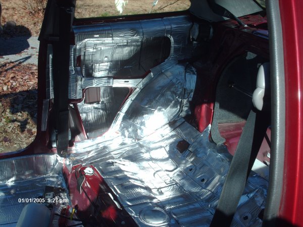

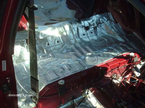

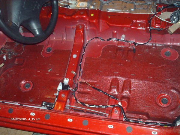

275sqft of v2 and 5 gallons of v3

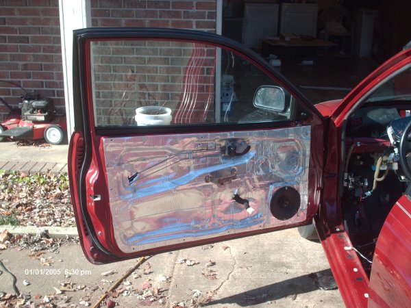

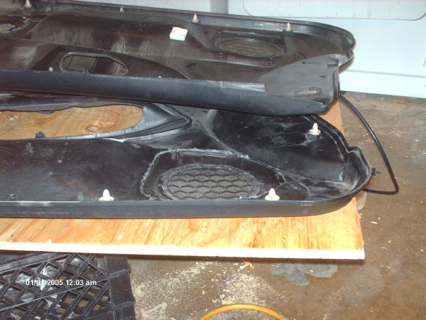

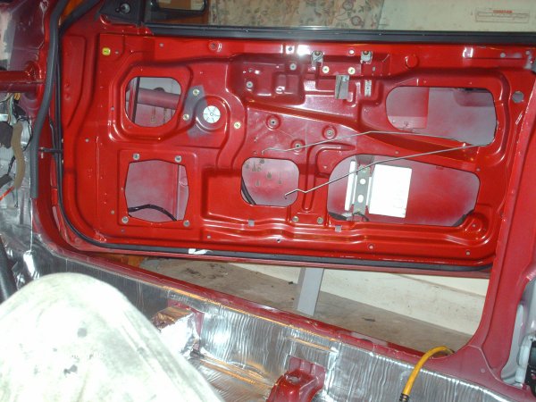

thats all the pics for now i will post more later as progress contnues.

yea we both have been off for the past 5 days for the t-giving holiday so yea we have had some time to work on it,

weve taken that car completly apart enough times that it aint nothing to put it back together. first time we took it apart was during the motor swap cause we replaced the entire wiring harness for the new motor. dash comes out in 15 minutes tops now.

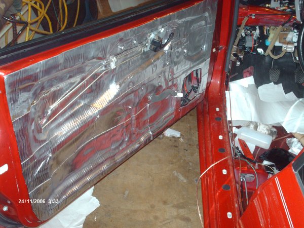

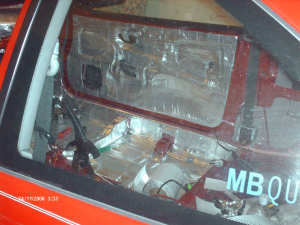

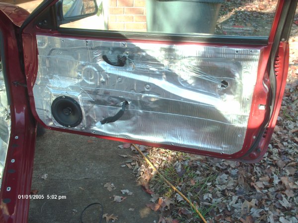

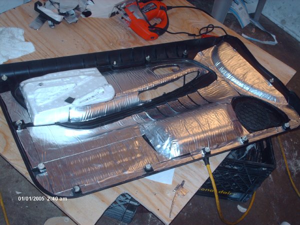

nah, im not an installer im just a a car audio lover lol. Best way i figured is to measure the area you wanna cover to figure the sq footage and just add about 50 extra to whatever you figure. you can always use extra in those loud spots. this car has 4 layers on the wheel wales. 4 layers on the inside of the door panels, 2 laters on the outside. floor pans have 4 layers firewall has 4 layers. transmission hump has 3 layers. as long as i didnt have to worry about a panel goin back there i loaded it down lol. i want this car quite as possible ya know. after we are doing laying this we have 5 gallons of black v4 on its way to us next week.

we figured about 110lbs with just the v2. plus anoter 50 with the v3.
