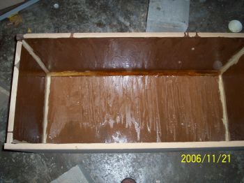

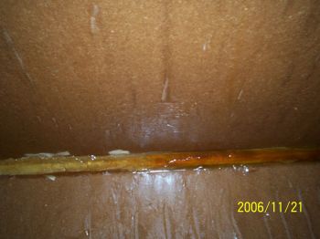

first caulked with latex caulk, then put on a
layer of fiberglass resin (no mats)
resin poured into the corner

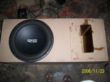

daily port ~34hz port....3.8 cuft net
i plan on cutting off ~1.5" because after putting in support boards, having the box slightly shorter than 16",and resining, the box lost some cuft, and i think the tuning is around like 31 - 32 now.

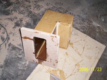

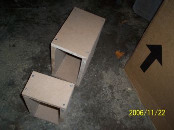

port with baffle on it, before sanding.
this is my cutting method used for the whole box. my cuts ended up coming out about perfect everytime, and the box ended up perfect.
Used a circular saw for the box, and a 36" ruler.
Username: Stnorris
Davenport, IA US
Post Number: 1749
Registered: Apr-06
cutting with jigsaw

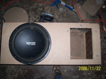

sub put in and bolts put in for interchangeable ports.

fiberglass resined port

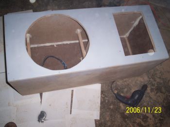

support bars

box with 1 coat of gray primer
port with primer, and 1 coat of paint

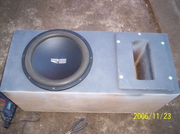

painted and primed. painted with black texture stone paint. (thanks meade)
wiring sub with 12 guage and 2 16 guages (its what i had laying around)
homemade speaker terminal on the inside of box. looks really good on the outside! (thanks cannan)
interchangealbe port in. port done with bolts and t-nuts (i need to get one more longer bolt). The port is also sealed with weather stripping but i dont have a picture of it. (thanks cannan)
sub installed. looks even better in person.

spl port. Part of it is external, part internal. i plan on putting a baffle in the middle when i make it.

upgrades that i didnt have on my old box:
resined inside
added 4 support bars
added 1 cuft
added interchangealbe ports
added homemade terminals
rounded out port

usin fiberglass resin inside of box does it make a diffrents like make it liek a lil louder? i no it seals it up a lil better but does it do anything else??
Username: Stnorris
Davenport, IA US
Post Number: 1773
Registered: Apr-06
helps air flow, and then it raises the peak freqency i guess around 1-2hz.
