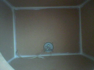

Inside....

lol thanx man, ya i just need to add the port which im gonna put it out the side, i wanna do it now but i gotta go to work in about an hour..
Username: Dustin3
Tigard, OR U.S.
Post Number: 4043
nice work TJ. you put a lil too many screws on the box, but its all good. i space every screw around 3-4 inches. and i see a couple screws in the first pic where the are really close to the corner of the box, i would go in about 2-3" before you screw in from the corner, or else ur gonna split ur wood. just some tips.. good job

lol ya i know thats alot of screws but i figured if i predrilled all the holes then the wood wouldnt split and it will hold stronger....so i did and i cant wait till it comes in.

just because you pre-drill doesnt mean ur wood isnt gonna split. you just need to be careful on the corners, not to place them too close

too many screws too close is a bad thing even u predrill
u ever remove some screws & look what happens 2 the mdf ? - it gets split slightly so now if u put them too near its like having a split throughout the length .
Glue is actually what holds the joints together .
Ever tried separating a well glued box ? - joints will almost practically NEVER come apart but wood around it will tear/rip
But good job overall - remember u can also use liquid nails as a joint glue as well as a joint sealer , this is what i do so u kill 2 birds with 1 stone ......

He He dont hate i did it in a hurry before work, and i did glue before i screwed the mdf together it wasnt liquid nails though, where do they sell that??
O and i didnt measure each screw together...it was to time consuming, but over all i think it will hold pretty damn good, i bought some glue from home depot it is the Elmers Multi purpose and it glued my port on pretty well so im sure it glued the box together real good....i predrilled all the holed first then put a thick layer of glue all around where i was gonna screw the board on then i put the board on and screwed those millions of screws so i think it will hold together pretty good.....
o i just noticed the back now he he ill have to add a few...

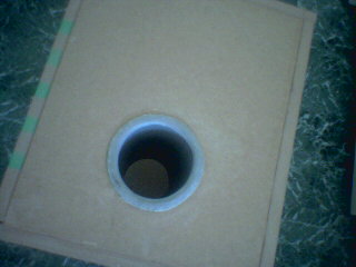

Here is my homemade flared port :-)
Username: Andrew571
Post Number: 191
not too shabby
