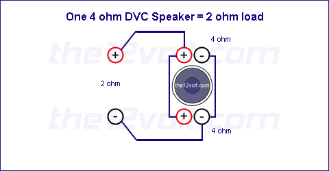

Gold Member Username: RovinTrinidad & T... Post Number: 9590 Registered: Jul-05 | yep ohms r easy 2 follow http://www.crutchfieldadvisor.com/learningcenter/car/subwoofers_wiring.html?subs =1 so if 1 sub is hooked up in parallel then ur amp will see a 2ohm load & should be getting 700-1000wrms & sound good enough i dont know specs of that JL box but somehow im guessing its too big recheck HU settings & amps settings like subsonic filter /gain etc ...... |
Bronze Member Username: Mike20Post Number: 11 Registered: Oct-06 | I Probly sound stupid but, since its a dual voice coil sub hook both up? And any certain way? Thanks for your help Rovin. Good lookin out. |
Gold Member Username: RovinTrinidad & T... Post Number: 9591 Registered: Jul-05 | u hook up ur sub like this using BOTH coils yes i try to do a good deed once in a while - lol ...... |
Bronze Member Username: Mike20Post Number: 12 Registered: Oct-06 | hahh.. Thanks again.. So u think since i didnt have it hooked up like that it could be why its not soundin good at all? |
Gold Member Username: James1115Ct Post Number: 7158 Registered: Dec-04 | yes, if you only had one voice coil hooked up that can be your problem, not wired correctly that could be your problem, faulty box? that can be your problem. You need to go through your system and eliminate one by one till it sounds good. Where do you live? sometimes other members live close and are willing to help others out. |
