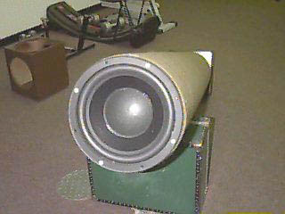

Gold Member Username: InsearchofbassPost Number: 4936 Registered: Jun-04 | http://www.t-linespeakers.org/projects/steve/index.html Thats the website above where I got this pic mine was mounted the oposite way of this pic...(mine was magnet out...which is fine as long as the sub is tightly sealed on the other side side)...this is the easy way to make a tline...check out the website to see more ![]() |
Gold Member Username: Basshead86Try Google Post Number: 7901 Registered: Aug-05 | looks like a futuristic sound weapon. lol |
Gold Member Username: FrkkevinResonant Engineering..., Fort Worth... Fort Worth, ... Post Number: 1443 Registered: Nov-05 | almost makes me want to experiment with tweeters, toilet paper rolls, and home-made funnels from a coke bottle... ultra-sonic-high-pitch-"futuristic-sound-weapon" .. wait no longer.. its arrival is now.. what a crude reality |
Gold Member Username: InsearchofbassPost Number: 4937 Registered: Jun-04 | LOL.....seriously though check out the weblink and youll get a better idea what they are doing...I was using 6 inch pvc but they are using sonotube |
