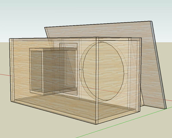

Gold Member Username: FrkkevinLake Worth, Texas US Post Number: 1286 Registered: Nov-05 | 17 x 39 x 16.5 5.046cu.ft (before displacement) 3 ports: 28hz - 10 x 3.5 x 25 35hz - 10 x 4 x 16.5 40hz - 10 x 6 x 20.5 The front of the box that is grey will be carpeted and mounted behind the rear seats directly to the trunk. The purpose of it is to seal off the trunk from the cabin. Not only that but it will make for a lot cleaner looking install . Of course that part will be assembled in the trunk first then the box will slide to it where it will then be mounted. This is a rough sketch but you get the idea.. ![]() |
Gold Member Username: AdddisorderWest palm, Florida Post Number: 1305 Registered: Jan-06 | looks cool, so i take it your looseing the back seat? one thing to consider is after you put screws in and out of the same hole in mdf it doesnt really stay in there becasue it doesnt grip anything. so if your changing ports a lot the screws might not hold after a while so maybe think of a better way to keep it attached |
Gold Member Username: FrkkevinLake Worth, Texas US Post Number: 1287 Registered: Nov-05 | t-nuts and bolts for the ports .. back seat is staying. this just mounts directly behind the back seat in the trunk. |

Gold Member Username: Extrmndor3Chicago, Ill Us Post Number: 2161 Registered: Feb-06 | hey kevin wat do you use to make those designs??? |
Gold Member Username: FrkkevinLake Worth, Texas US Post Number: 1290 Registered: Nov-05 | google sketchup |

Gold Member Username: FrkkevinLake Worth, Texas US Post Number: 1291 Registered: Nov-05 | i use bass box pro 6 for the actual box and then transfer my plan to sketchup |
Bronze Member Username: Kai2780Post Number: 14 Registered: Oct-06 | so, you insert the t-nuts into the baffle and then attach using screws through pre-drilled holes in the box. is this coorect? will you be rounding the edges of the baffle? |

Gold Member Username: FrkkevinLake Worth, Texas US Post Number: 1293 Registered: Nov-05 | yes .. and no .. the only edges that will be rounded is the port edges |
