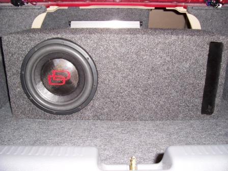

Silver Member Username: Nyyfan13VA USA Post Number: 291 Registered: Jul-06 | also would this be what my box would look like of am i imagining it wrong? and yea i stole these pics from muddys system so thanks muddy. but is this what my box will resemble? |
Silver Member Username: Nyyfan13VA USA Post Number: 293 Registered: Jul-06 | and yea i got no problem with 2.1, i just wanted to make sure i knew what was going on. |
Gold Member Username: FrkkevinLake Worth, Texas US Post Number: 1151 Registered: Nov-05 | similar yes.. if you want to get the loudest i'd fire the sub up and the port back .. i did not design a long port to fit on the bottom of the box because it would prolly not be very wide .. placement is up to you... whichever you find easier |

Silver Member Username: Nyyfan13VA USA Post Number: 296 Registered: Jul-06 | the box will resemeble muddys up there and if i dont like how it sounds firing towards the rear of my car, can i just flip it up shooting up towards the roof? or is that just dumb? |
Gold Member Username: FrkkevinLake Worth, Texas US Post Number: 1155 Registered: Nov-05 | flip it however which may you think it sounds better.. reason i say it would be louder if you built if with the sub on top and the port on the side firing towards the back is because that scion is like a mini-suv of sort.. either way its going to sound good. i'd do whatever you were comfortable with. if you don't like it you can always build a new one later on down the road ![]() |
