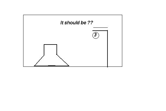

WOOOW , Its Very Hard , I read all of sites and I was reading for about 4 hours , Okay Now I know a little bit , But still do not know how can I build mine .
I edit @ DD's Box , Its look like which I want to build but a bout information's I just do know these :
1 -- Its 40Hz , But how can I reach that Hz I don't know .(Ok MuDDy I know lower tune is usually LESS port area and MORE port length , a higher tune is usually MORE port area and LESS port length ) But how can I know its 40 Hz ..
2 -- Mounting Depth 6 7/16" but what does 6, 7 and 16" Means .... Its For what .. why they wrote three numbers ..
3 - Volume 2.50^ft
4 - 37.50 sq" vent x 16" long .. WHATS THAT ??
and Many Dimensions Still Wanted ??
But in DD's Website they Draw this
I have 2 do it just like that or just like whay i drawed ..
Username: Basshead86
Google is your Friend, FL
Post Number: 5896
Registered: Aug-05
Ok...i will give this a try.
1. to acquire a certain tune, ANY tune...is based on how MUCH port area you have and how LONG the port is. get a box...find how big it is.... then find how much port area there is(opening of the
port width and height) then hit the calculate button, and it will spit out a PORT LENGTH or DEPTH to Acheive the desired tune.:-)
2. the mouting depth is measured from the back of the MOUNTING ring on the sub...to the tip of the subs back plate. 6 7/16" = 6 inches, and a 7/16th of an inch. so you would take 7 divided by 16 and get .4375, then you would add that to the original 6 inches to get 6.4375 inches for the subs mounting depth.:-)
3. the volume of the box is the Length(Depth) muliplyed by the Width mulitplyed by the Height of the inside of the box. TO get these inside measure ments...you take each of the outside ones and subtract 1-1/2" from each...3/4" MDF on both sides gets that number. or 1.5" from each to make it into a decimal. after you have multiplied each number together you get a really large number.
lets say you have a box that is 38"(L) x 24"(W) x 17"(H)
you will take 1.5" from each measurement to account for the thickness of the wood on BOTH sides of the box... 3/4" + 3/4" = 1/5" :-)
so now we have 36.5"(L) x 22.5"(W) x 15.5(H) for the internal measurements of the box.
which comes out to 12,729.375" cubed...cubed b/c there are 3 measurements....it would be square if there were only 2, but that is for port area.:-)
1 cubic foot is 1,728 inches. so to find the CUBIC feet of the internal dimensions we divide 12,729.375 by 1,728....and get 7.366 cubes.
The internal cubic feet of the enclosure is 7.3 cubes:-)
4. 37.50 sq" vent x 16" long
the 37.50 square inches(b/c it is 2 dimensions multiplied together) is say 3" wide...and 12.5" high. so you take 12.5" x 3" and get 37.50", which is the PORTS AREA.... the 16" is how long(deep) the PORT must be in compliance to the BOX's cubic feet to get the 40hz tune.
if the box was larger...the port would need to be SHORTER to maintain the same tune.
see how this box is 3 cubic feet and has 34"sq.in. of port area and the port is 29" long to get a 30hz tune.
http://www.subwoofertools.com/forum/ported-box.asp?Ew=38&Eh=14&Dia=6&Xmax=22&Vd= .16&NumW=1&Vb=3&Fb=30&Qts=&Vas=&Fs=&CE=0
now this box has 7 cubic feet and has 34"sq.in. of port area and the port is 9: long to get a 30hz tune.:-)
WHEW!!!!!!!
that was a LOT of typing.:-)

here is the one the guy who builtmy box used from DD
1.50^ft-(1) 10" subwoofer-22.50 sq" vent x 16" long-tunes to 40Hz
