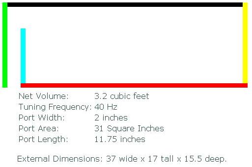

Does this look good for a box? Any suggestions?Upload

n/m Im lookin more at somethin like this.
Net Volume: 4 cubic feet
Tuning Frequency: 40 Hz
Port Width: 2 inches
Port Area: 31 Square Inches
Port Length: 8.5 inches
External Dimensions: 37 wide x 17 tall x 15.5 deep.
DD recomends more port area and length http://www.ddaudio.com/dd/caraudio/enclosureInfo/boxSize_hiEff.asp Does that matter?

i would go with 4 cubes net.
16 sq. inches of port area per cubic foot.
and tune to say 35.:-)

why do i only have 31 square inches when i have a 4ft^3 box. the information i gave about the box was from a dimention calculator that said it was tuned to that frequency. what am i doing wrong?

5 cubic ft, 90 square inches of port 16" long,
trust me :-)

my friends is 4.5cuft 80 inches of port at 38hz and it kills. if you have the room go huge.
