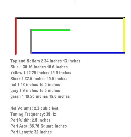

Bronze Member Username: Adam_sPost Number: 55 Registered: Aug-04 | OK this is going to be the first box that I have ever built and I am wondering what you guys think of this plan. It is going to be for a 12" Arsenal. Is it big enough and how do u think it will sound. Also does where I put the sub matter??![]() |
Gold Member Username: BestmankindLos Angeles, CA USA Post Number: 4592 Registered: Oct-05 | ok i can't see the pic. |
Gold Member Username: BestmankindLos Angeles, CA USA Post Number: 4593 Registered: Oct-05 | nvm i see it. looks like a killer spl box. |
Bronze Member Username: Adam_sPost Number: 56 Registered: Aug-04 | will it sound good for everyday driving too?? and I plan on putting the sub on the blue part but does it matter where on there?? |
Gold Member Username: BestmankindLos Angeles, CA USA Post Number: 4594 Registered: Oct-05 | isn't the arsenal a sq sub? if it is you should go with a smaller port area. it will sound better. |
Gold Member Username: RovinTrinidad & T... Post Number: 8736 Registered: Jul-05 | persoanlly i dont like a 35hz tuning coz i like more SQ in my loud -lol i'd say tune either 32/33hz - ur music will sound alot more accurate & pleasant ..... |
Bronze Member Username: Adam_sPost Number: 57 Registered: Aug-04 | really...I really dont know much at all about building boxs so I just went on a site that calculates it depending on what u want it tuned to and on the AA site it said 35 hz so This is what i came up with...any help on what I should do would be greatly appreciated. Im not really sure what you meant by smaller port area |
Gold Member Username: RovinTrinidad & T... Post Number: 8738 Registered: Jul-05 | when u tune it lower u will automatically get a smaller port area ...... |
Bronze Member Username: Adam_sPost Number: 59 Registered: Aug-04 | ohhh ic....so even tho the AA site says 35 I should go to like 32?? I am just trying to get something that is going to be loud but I also dont want it to sound bad becuase I will ride in the car everyday. another thing is that i mainly listen to rap if that has anything to do with it at all. |
Gold Member Username: RovinTrinidad & T... Post Number: 8741 Registered: Jul-05 | 32hz is really my personal fav tuning so im not saying that u have to - it gives a nice mix of sound quality & loudness with good accuracy 35 is more on the SPL side of things never used a arsenal b4 but seeing that its Fs is = 27hz , 32 should be fine IMO ........ |
Gold Member Username: RovinTrinidad & T... Post Number: 8743 Registered: Jul-05 | damn post wont bump ...... |
Bronze Member Username: Adam_sPost Number: 60 Registered: Aug-04 | alright....Thanks. I am just kinda nervous about it cause it is the first box and the first quality system I am putting together and I just want to make sure I am doing everythign right. because the subs I have now are in a horrible box and sound like hell. |

Bronze Member Username: Adam_sPost Number: 61 Registered: Aug-04 | heres the site ur looking for http://www.subwoofertools.com/forum/ported-box.asp?Ew=34&Eh=17&Dia=6&Xmax=20.5&V d=.12&NumW=1&Vb=2.3&Fb=32&Qts=&Vas=&Fs=&CE=0 |
