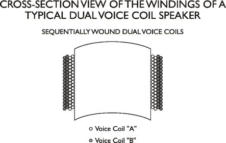

They indeed are made that way for more wiring options, but look at the way the coils are wired:
You can only wire up one coil, but then you've completely changed the parameters of the sub (and will need a new box-good luck guessing what the new parameters of the sub are so you can build the right box), not to mention it won't be able to handle as much power. In essence, you can do it, but it's just not a good idea.
