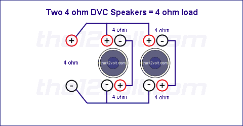

http://www.the12volt.com/caraudio/woofer_configurations.asp

does this diagram mean that the amp has to be bridged? does anyone know
Username: Gangstafert
Jacksonville, Florida USA
Post Number: 248
yes, wire them like it says above then you should be giving your subs their rms.

the problem is that you say you have 2 subs, and each one is 2 ohms, menaing you can only wire to a 2ohm load, where the amp does 250. if you had DVC 3 ohm subs you could bridge it and get 500 total watts.
correct me if i'm wrong ,lol its 1:00 here
Username: Dustin3
Tigard, Or U.S.
Post Number: 2070
DVC 4 ohm subs****
Username: Dustin3
Tigard, Or U.S.
Post Number: 2071
because you cant wire to each channel because its a DVC 2 ohm sub that can only wire to 1 or 4 ohms...

take the second sub off that chart, and its wired @ 4 ohms with 1 sub?
Username: Tjmutlow
Post Number: 2561
Registered: Sep-05
there is no way to wire 1 dual 4 ohm sub to 4 ohms,
Username: Dustin3
Tigard, Or U.S.
Post Number: 2079
and the chart that rovin showed is only if you had the DVC 4 ohm subs and bridged it to 4 ohm
