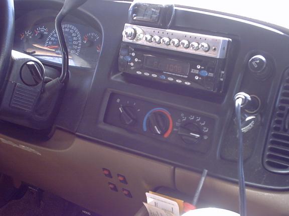

I had probs putting in my HU and EQ into my dash. My solution: 2 universal kits, and a tube of super glue. I cut the brackets off some of the kit and glued them to where the stock mounting bolts were. Its solid now. Put a few drops around the edges as well. Im dreading the day it has to come out.Lol
