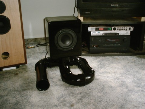

Gold Member Username: InsearchofbassPost Number: 4819 Registered: Jun-04 | Dividing your chambers is one thing I forgot to remember. Dividing the chambers is good not only for support but also good if one or two of your subwoofers blow. Using the wesite I provided should help you downsize alot even with the extra width of the dividing dividing chambers. Rovin..."if u port with pvc pipe the box will be alot smaller than if u slot port ...) A) I agree. Also if your really crunched for space or just plain want to get creative you could port using pvc externally rather than the traditional inside the box approach. I'll see if I can find you the site to illustrate what I mean. |
Gold Member Username: InsearchofbassPost Number: 4820 Registered: Jun-04 | here you go![]() |
Gold Member Username: InsearchofbassPost Number: 4821 Registered: Jun-04 | I made a joke once on this subject about making header pipes using this approach. If you were using say one sub you could make one functional and the rest nonfunctional to create the appearance you want and you could paint the pipes or use whatever material you wanted overtop of the pvc. An example might be using fiberglass over the pvc. |
