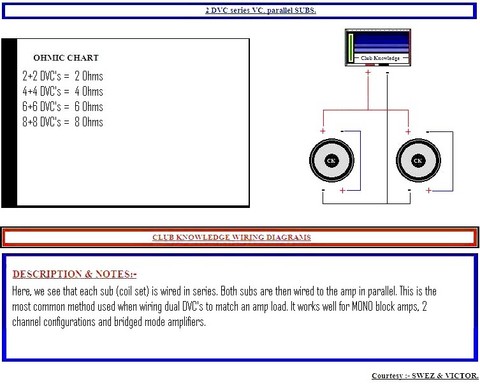

This is the diagram that I used to hook two DVC 4Ohm subs to 4Ohms, so it should work for you too.

it should work fine, it would create a 4ohm load per side in box, then a 2ohm at the amp....
