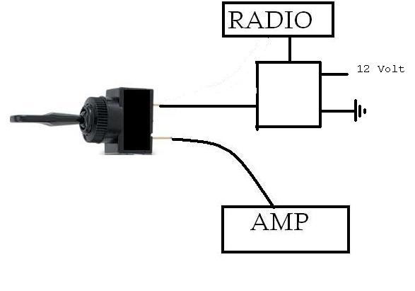

ok i want to put a toggle switch so i can turn the amp on and off when i want. but im a lil confused on how to wire it. Upload is this way correct if it is then what would be on and whats off

the switch should have 3 prongs and one of them will be left unconnected...thats how mine is anyway
Username: Serius
Miami, FL USA
Post Number: 74
mines doesnt
Username: Shman
Grandville, Michigan United States
Post Number: 156
well then thats probably a switch where the center position is off...
Username: Serius
Miami, FL USA
Post Number: 75
good point..so i just wire how i have it there?
Username: Shman
Post Number: 157
yup

ok i know exactly whut u mean......i have a toggle switch for my H/u....
actually that right....it'll work...yeah output going to the remote power on...line..(on the amp)..thats it

ok i wired it up but there isnt a middle position so wired both of them to 1 prong and it dont work if i wire one to one side and one to the other whats would be off? or should i just buy a 3 prong one?

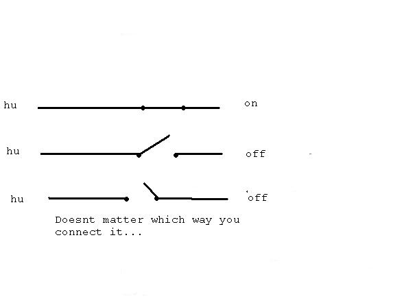

is that pic on top the same as yours?

Is that a lighted toggle switch? 3 prongs yes. 2 prongs no
on a 3 prong: 1 is load (Rem out )
2 is (rem in)
3 is ground.
on a 2 prong; 1 in
2 out
If its lighted you may want to use a relay on it... I lost 1 volt on my led switch. times that by 4 and there was no power to turn on my amps (even with a relay). I had to use unlit rocker switchs. That was not fun to figure out... Finally broke out the DMM and found that the switches were hogging my juice.
Username: Serius
Miami, FL USA
Post Number: 79
no it isnt led. it has two prongs so if i do one in and one out whats off towards radio or amp?
Username: Van_man
Boston, MA
Post Number: 248
doesnt matter...
BTW here a relay pic
And my 4 rocker switches bottom left of pic

ok i understand how to connect it but which way would be off?
Username: Van_man
Boston, MA
Post Number: 252
If its a 2 prong it dont matter Is it labeled on-off face it up that way

dats not the ppoint its to have control to turn it off wen im in the car driving

If you are talking about the remote wire from your HU to the amp, the yes serius, your first pic is right. Depending on whether your remote wire is going to your HU, or to the fuse box. But either way, a switch on the remote wire will work.
