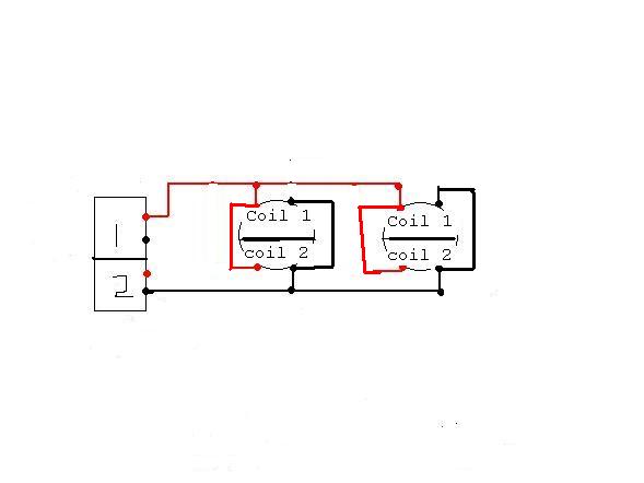

Ok, I am trying to hook up my new Crossfire 600D to my 2 Arsenal 12" subs. I was going to run the amp at 1 ohm. I hooked everything up exactly according to the diagram shown belown (2 DVC 4 ohms subs) and it worked but sounded more like 300 watts instead of 600+ watts. Basically, my old 450 watt kicker beat it out. I don't know what is hooked up wrong. I have 4 speaker wires coming out of the amp even though it only shows 2 (I dont see how that is possible). Anyway, Please someone help.

what do you mean, "I have 4 speaker wires coming out of the amp even though it only shows 2 (I dont see how that is possible). Anyway, Please someone help." are you using 4 speaker wires for two subs? You should foolow pic with + from channel 1 and - from channel 2

follow the pic exactly and you will have no problems.

you only need one wire coming from ur amp, like the picture shows. you take the left - channel and hook it to the negetive on one sub and also on the other sub. you can do this by splicing the wire into 2 parts or you can just cut it in half and use as two seperate.
same on the other side but with the positive wires. then after you do all that you need to connect the VC's, so you take a part of speaker wire and connect the 2 neg on the first sub and the 2 ned on the 2nd sub(these dont conncect to the amp) and then you do that to the positive ones (also not conncected to the amp) - you are just completing the circuit.
thats the best i can do
Username: Seth_walker
U.S.A.
Post Number: 109
No. just have one wire coming out of the (+) of the amp and going to the (+)'s on the subs and one wire coming from the (-) of the amp and going to the (-)'s on the subs, just like the diagram.

Username: Iufan4lifeul
Post Number: 1019
Registered: May-05
that looks different than the original picture.

no, on the first subm both neg need to connect (the VC's). and then the red wire on the top needs to conncet both the positives, same with the other side. ur diagram is a bit confusing with the postive wires on the sub side. in the diagram you are not connecting ur VC's. you need to connect them. just stare at the 1st diagram for lil bit until you understand. thats what i had to do my first time.

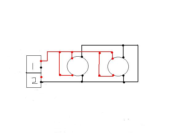

Username: Van_man
Boston, MA
Post Number: 227

that diagram isnt right. ur coil 1 pos on both sides needs to be connecting to both positives.

Use positve from amp channel 1
use negitive from amp chanel 2
run + from amp chanel 1 to all voice coil positves
run - from amp channel 2 to all voice coil negitives, clear??????????????????????????

Username: Van_man
Boston, MA
Post Number: 232
is this better.... Upload

yea thats better chris. i knew what you were tryin to get at but chris needs it as clear as possible. marcs diagram is perfect. just follow that.
and yea, LOL, you dont need to bridge it, i though it was a 2-channel. my bad.
