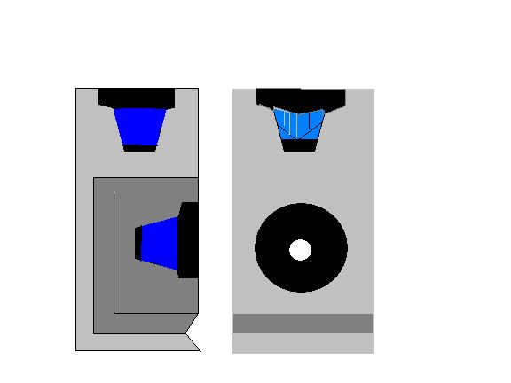

Heres a sketh of one ive been tinkering with
Needs to be worked out tho...

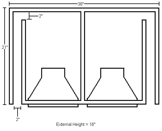

This is what i came up with.
image/bmpUpload
the port is 14.5x2 inches (29 sq. inches of port)and has 22.9 inches of effective length. the box is 2.33 cu. ft. Would this be what u are looking for? I'm pretty sure this would work but if am one else wants to input that'd be great.

Sorry that's so hard to see. How do you post in the forum? anyways the way i have it the subs would BARELY fit. Do subs need side clearance because what with what i figured they'll have .1875" clearance on the top and bottom, and .5" clearance on the sides.I used the 16x38 side to mount the subs.

Sorry try this oneUpload

On my previous design i made a slight mistake. I showed the port making a slight turn but in fact you don't need that part. just make sure the port ends 2" from the end of the wall. These figures give you a tuning really close to 35 hz. the port is actually about .08" longer than what it should be. this actually makes the tuning 35.6 hz according to my calculations.

So heres my box.
Username: Van_man
Boston, MA
Post Number: 160
nice job, man that things deep...
Username: Seth_walker
U.S.A.
Post Number: 45
Ya I know. He said that the dimensions were 16" height, 21" width, and 38" depth. I wasn't sure if he wanted the face to be 16x38 or 21x38, so i just choose the 16x38 cuz it made it a bit easier to calc. Hey Jordan let me know if you want to use the other side as the face and i can prolly recalc it, that's if you wanna use my design. here's a bit better drawing. oh and i assumed 0.75" MDF.

The measurements on my box are to the outside. I cannot see why my design would not work. Like i said it's tuned to about 35.6hz. If anyone else wants to comment i'd love the input. And yes the Fo is the same as the Fs.

i wouldnt use a port smaller than 3", at the very least

Even for a slot port? i had heard that you should stay below a 8:1 ratio on slot port? the total area is 29 sq. in. for 2.33 cu. in. so i know there's enough port are. can someone explain this?

Your box should work Seth. Thats how i'm going to try and build it

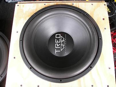

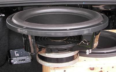

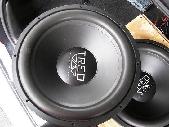

Username: J_baby15
Kentucky
Post Number: 215
Username: J_baby15
Kentucky
Post Number: 216
There yall go. Now you have pics. Go ahead and Post some Polo, i dont mind.
You can see thats theres some scrathes on them, but the cone and surround look almost new with the exception of one little nick in the surround of the one thats not in the box yet.
I've hooked both of them up and they work perfect, I would say not a bad buy for $260 shipped:-).Lemme know wat yall think, Right now that one is in a sealed box i had for my L7, its about 1.8cuft. and sounds really clear, but i only have 300 watts goin to it.
