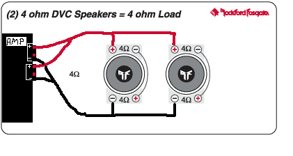

i got two compvr 10's dual 40hm and im bidding on a A8002t for them rite now but till then i was wondering if i could run them off my PA OV4-600 http://www.cardomain.com/item/POWOV4600
when the amp is in bridged mode its only stable @ 4ohms i was jsut wondering id if wiring them like in the diagram would present each channel with 4 ohms
i drew a diagram of how i was gunna run them but jsut wanted to know if it would work...i know if it does work it wont be loud...but its jsut temporary till i get my sub amp...thanx in advanceUpload

Yes. Attach One voice coil to each channel on the amp.

The wiring in the picture won't work. The amp is a four channel amp and you subs are DVC. Thats four voice coils and four channels. don't bridge the amp.
