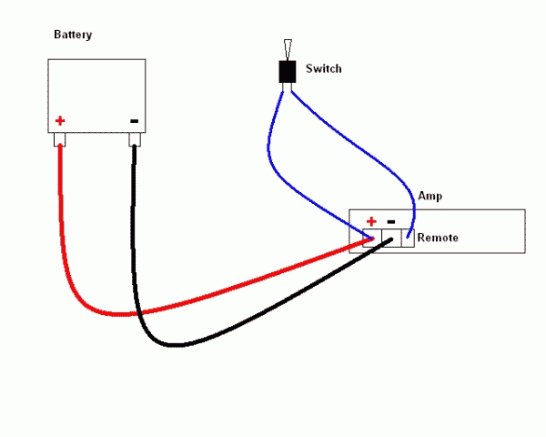

or you could run it off your 12v input on your amp. Just run a wire from it and put a toggle switch on it so the amp won't always be on. Then just run it back into the amp. I'll draw a diagram and show you what I mean

Bro, if u take a wire and connect it to any thing that has a 12v pos+ power terminal and connect it to the remote terminal on your amp it will work, but u want to be able to trun your amp off, so u put a toggle switch in between the pos+ terminal and the remote terminal on the amp. All the remote terminal is for is turning the amp on and off, it doesnt actually power the amp the 12v pos+ input does. So like Young James was sayin, u can connect a wire from the 12v pos+ on the amp to the remote terminal on the amp. But u need a switch. Again the cigarette lighter on some auto's turn off when the car is off making it a remote wire.

Username: Young_james
Post Number: 1395
Registered: Sep-05
That's he diagram that I was talking about, but it wouldn't let me upload it

Young James, I modify my files with IrfranView to get them to post on ecoustics. In this case I had to change the paint BMP file to a JPG.
