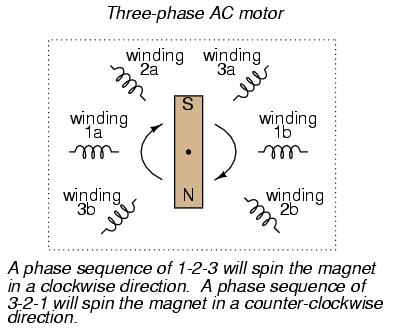

Silver Member Username: LbecknerTulsa, Ok Usa Post Number: 816 Registered: Oct-04 | Your an electrical engineer and you dont know how to reverse the direction of a three phase motor? Thats like day two. And I'm not trying to show off someone said that maybe he plugged it in backwards and another guy said that you cant plug ac in backwards. Do you homework instead before you try to tell me I don't know what I'm talking about. |
Silver Member Username: LbecknerTulsa, Ok Usa Post Number: 817 Registered: Oct-04 | http://www.allaboutcircuits.com/vol_2/chpt_10/4.html Maybe this all about circuits web page will help complete your degree Mr. EE. ![]() |
