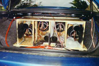

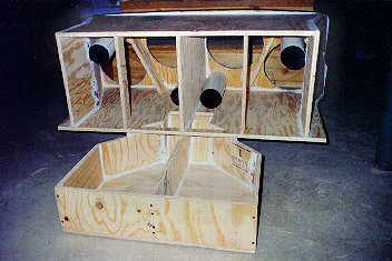

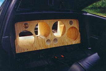

Silver Member Username: Safe_crackerChicago, IL US Post Number: 581 Registered: Jan-06 | You guys cannot be serious! This is a sub that is approx 13.5" DEEP, that means it will not fit in a spare tire well, not even close. Also this is going to be 5cf and ported through the back deck. I will be using a small amount of glass/resin on the inside but a custom FG enclosure is out of the question. What I am trying to do is to close off the trunk area te get rid of extra space to boost spl a little and to cut down on trunk lid flex. I have it all planned out but have mixed reviews on materials. I know MDF is always used becasue it is cheap, but there isn't a preset budget here. Here is a picture similar to what I am trying to accomplish. Polo. |

Silver Member Username: Langless28Post Number: 384 Registered: Dec-04 | on those pictures, what is the thing under the box, it looks connected, is it for the amps? |
