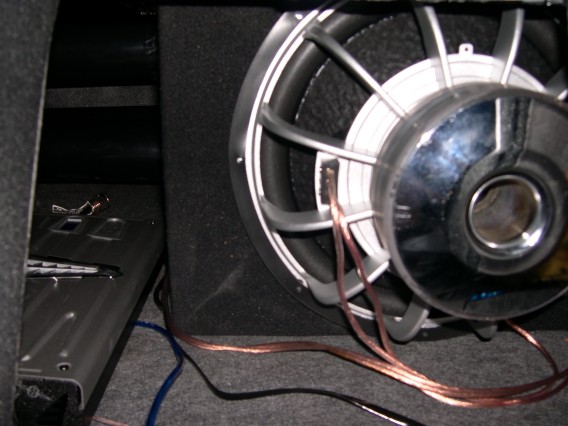

Silver Member Username: Safe_crackerChicago, IL US Post Number: 437 Registered: Jan-06 | I bought a TCAB box for the fact he lives within 40 miles for me and it allowed me to drive down there, talk with him (pick his brain) and I even bought a used box, the one on the Pontiac Video because I knew it was tried and true also because I have a Pontiac so the tuning would be close. The one thing I would have to say is the SX 15 is a lot louder and cleaner than a type R so that said you can imagine how mine sounds. I don't know if this makes a difference but my box seems to be made out of 3/4" birch ply which is MUCH lighter than MDF and seems to have a deeper sound. I bought this box so as to get ideas how to make my own later, as a learning aid. $215 maye to you guys be an expensive learning lesson but think about how much testing went into this box and it wasn't done by me! Polo.. ![]() |
Gold Member Username: SouthernrebelMonroe, Louisiana USA Post Number: 2410 Registered: Mar-04 | polo...does that box have 4 4" ports or 6"? |
Silver Member Username: Safe_crackerChicago, IL US Post Number: 441 Registered: Jan-06 | Ummmm, you trying to figure the tune on it aren't you, lol. Yes Marshall thems 4" ports. The tuning comes out to be 41hz and around 37-ish in vehicle. The box is 4.47 gross internal volume and because the ports/sub are external it is the net too, lol. |
Gold Member Username: SouthernrebelMonroe, Louisiana USA Post Number: 2411 Registered: Mar-04 | i'm just wondering...i'm doing a box for my SX15 w/ 2 6incher's. should be interesting to say the least. 37hz in vehicle...man...that seems kinda high to tune an SX for daily IMO. but if it sounds good...it sounds good (i like my daily bass to be brown-note style though ) what kinda of numbers are you doing w/ that setup? on what amp(s)? |
Silver Member Username: Safe_crackerChicago, IL US Post Number: 443 Registered: Jan-06 | I lover lower notes too but you don't tune one of these boxes at its lowest note. You need to tune right in the middle or slightly lower because this is not a slot ported enclosure, it will play 25 to 80hz easily. Matter of fact for techno I pust it up to 90hz to blend with the mids a little better. Most people like tuning there boxes extremely low because it lessens car rattle. Most car rattle happens above 50hz so when people hear the low notes it does sound better because most of the rattle is gone and you still get good shake. Now if you take and tighten up a vehicle, add some deadening material to get the higher rattles down to a minimum then tune the box to around 40 hz aim the ports to the rear, it is going to tune around 35hz BUT it will play all the notes from around 22 to 75-80hz and do it without wasting as much amplifier power on frequencies below the audible range. When a car flexes it gives off its own low frequencies which can be felt. I don't know how well this will work in a hatch back but Mark does run them in his blazer here is a picture of his box. Polo.. |
