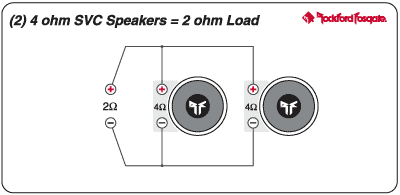

first off, in order to run the amp at 2 ohms you would either need another svc sub or one dvc sub. this is how to wire it if you have 2 svc subs: http://www.crutchfieldadvisor.com/learningcenter/car/subwoofers_wiring.html?subs =2&impedance=SVC4
(follow the top diagram not the bottom.)
this is how to wire it with one dvc sub:
http://www.crutchfieldadvisor.com/learningcenter/car/subwoofers_wiring.html?subs =1&impedance=DVC4x2
(again follow the top diagram.)
Username: Bachatero07
Post Number: 61
sorry, copied the wrong link. on the first link follow diagram #6. the one that says "(2)4 ohm svc speakers = 2 ohm load". on the second link follow diagram #3. the one that says "(1)4 ohm dvc speaker - 2 ohm load".
Username: Error_505
Amory, MS USA
Post Number: 10
Is this image showing running the subs paralell or both positives to the positive on the amp, both negitive to the negitive on the amp? The pics only shows ONE channel, I would have 2 channels.

Rockford Fosgate Punch P6002 2 channel amp
150 x 2 RMS @ 4 ohms
300 x 2 RMS @ 2 ohms
600 x 1 RMS @ 4 ohms
actually your amp puts out most power at 4ohms. 600rms...
u have single 4ohm subs, so u cant do match at all!!
if u hook each sub to its own channel they get a messley 150rms...
u can get some Dual Voice Coil subs to have alot more configurations, instead of being stuck with 1 config!

to optimize that setup, u need a amplifier that will put out your both subs combined RMS power at a 2 ohm load!
Look for any 400-500 rms rated amplifiers that are 2ohm stable...

get and amp that is mono...that means it has one channel...so that it would say in the specs...500x1@2 ohms....

You have already been told, you can not run that amp 2ohm bridged, never mind go ahead a do it, it is going to clip out and eventually burn out, you have been told how to do it with those subs or what amp to buy.

no prob, i would sell those subs if possible and get the dual 4 subs, or sell the amp and get an amp that is 2ohm stable, like the kicker 600.1 or maybe an alpine mrd-m605.
