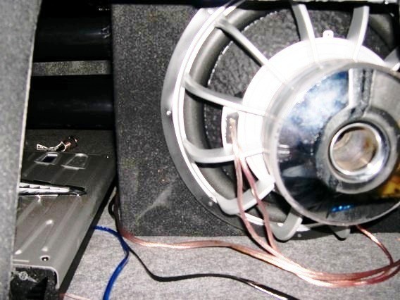

Silver Member Username: Safe_crackerChicago, IL US Post Number: 414 Registered: Jan-06 | External Aero ports boost SPL a bit more.(in background) ![]() |
Gold Member Username: B101Queen City, NC USA Post Number: 1691 Registered: Sep-05 | I was talkin about Aero ports, like what Polo got there... Ports facing toward trunk(back), subs firing upwards(top), yeilds the most SPL most of the time!! tune box around 30-35 for sound quality! 35-50 for pure spl, yeilds way louder score on mic! |

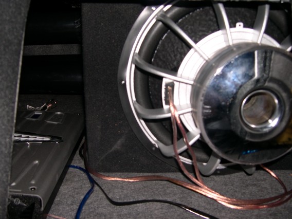

Gold Member Username: B101Queen City, NC USA Post Number: 1692 Registered: Sep-05 | here is a alot brighter pic of his box... ![]() |

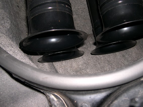

Silver Member Username: Safe_crackerChicago, IL US Post Number: 417 Registered: Jan-06 | Larger box+more ports+more frequency+more power= More louder, lol. B your right about the upward firing, rear port box but mostly in like Hatch backs and SUVs. In a trunk vehicle it tends to lose a little energy due to the flexing trunk lid. To gain the most enery possible from your ports I recommend them to be 90deg angle from the sub. I could run these ports internal with a small loss but it looks freaky for sure.Here is what Aero port ends look like. Polo.. ![]() |
