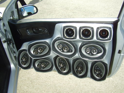

maybe u oughta do like this >>>>
LOL - Upload
Username: Tdeaton1021
Near Tampa, Florida USA
Post Number: 2246
Registered: Sep-04
ahh no thanks lol. im going to make fiberglass inserts where my speaker grills are but im not going to cut or do anything to the door so i can make it stock again when she has to go.
Anonymous
ahh.... what the hell is that?? did some one get bored? what about imaging? oh i see your going for loud lol ive never seen that before.
