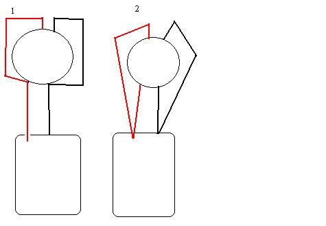

Username: Ironslave
Post Number: 103
Registered: Sep-05
heres your options.... it'dosent truely matter which one you use... although i perfer 2...Upload
i would just feel safer with option 2
