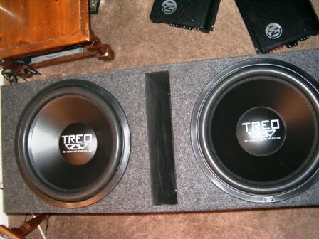

Gold Member Username: B101Queen City, NC USA Post Number: 1212 Registered: Sep-05 | Im tellin you guys, this thing sounds like its SEALED, its tuned LOW to 27hz. It feels like it ported though... ![]() |
Gold Member Username: B101Queen City, NC USA Post Number: 1213 Registered: Sep-05 | look how huge that thing is with that lil port.. ![]() |
