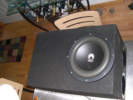

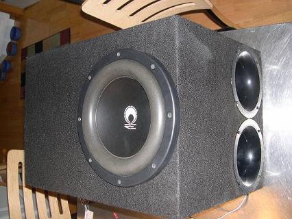

Username: Ishkabobble55
Erie, Pennsylvania
Post Number: 184
even if i hit 140db id be really happy heres the picsUpload
Username: 54danny54
Betsy layne, Kentucky..GO... USA duh
Post Number: 1698
Registered: Nov-04
those are HUGE ports lol
Erie, Pennsylvania
Post Number: 187
and those are the little ones he uses!!4" he has now moved up to 6" ports which are about the size of my sub!!!
