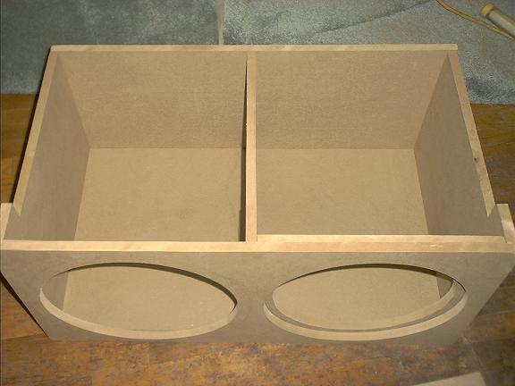

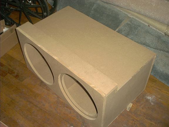

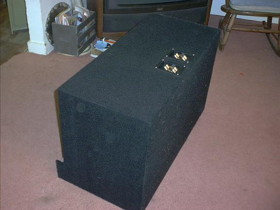

Bronze Member Username: Bp317Post Number: 42 Registered: Aug-05 | well, i took the advice i found on here and a few other sites and designed and built my own boxes. they arent done yet but they both have 2 cubes a piece and are tuned to 42hertz. its my first box, remember, so take it easy. haha [IMG]http://img.photobucket.com/albums/v235/gstunts/DSC00025.jpg[/IMG] [IMG]http://img.photobucket.com/albums/v235/gstunts/DSC00026.jpg[/IMG] [IMG]http://img.photobucket.com/albums/v235/gstunts/DSC00024.jpg[/IMG] the circle was a rough cut, we sanded it down some. [IMG]http://img.photobucket.com/albums/v235/gstunts/DSC00023.jpg[/IMG] i found some spring loaded terminals and i think they look pretty good. |
Bronze Member Username: Teddy21Ann Arbor, MI USA Post Number: 12 Registered: Feb-06 | what kind of subs u using? |
Gold Member Username: SouthernrebelMonroe, Louisiana USA Post Number: 2064 Registered: Mar-04 | the wood working itself looks pretty good. but how much port area does that have? you should try to get 12-15sq inches of port area per cubic foot are air space...or you will prolly get port noise. for a first box...that pretty good though. |
Silver Member Username: MixneffectOrangevale, Ca. USA Post Number: 805 Registered: Apr-05 | I m not sure, but it seems that the caulking is just sitting in the corners. Here is a tip; Use your finger and spread it smooth and work it in the corners. Just run your finger at an even speed so it will seal 100%. If you use spit on your finger before you work the caulking it will not stick to your finger. You gotta spit on your fingers quite often otherwise it may stick. |
Bronze Member Username: Bp317Post Number: 43 Registered: Aug-05 | 2 12" mtx 8500's. the ports are 8x2x8. we smoothed out the caulking after some some of the pictures. thanks |

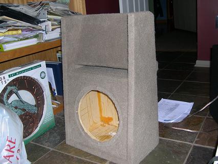

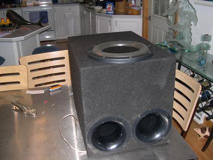

Silver Member Username: Ishkabobble55Erie, Pennsylvania Post Number: 196 Registered: Jul-05 | this is was my first box- ![]() and this is my new one- ![]() by the way you did an awsome job on your first, my cubic footage was way off in mine! lol |

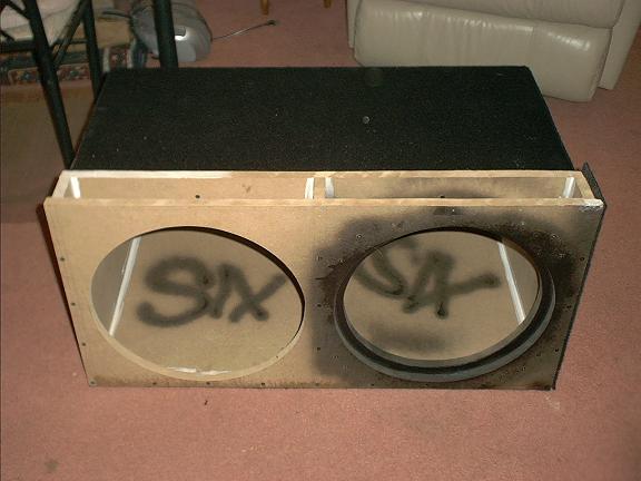

Silver Member Username: SixFlint, MI U.S.A. Post Number: 357 Registered: Oct-05 | ![]() ![]() ![]() ![]() My first... (I inserted the 2nd baffle right after the last pic) |

Silver Member Username: Terry6405Sullivan, IN US Post Number: 270 Registered: Sep-05 | how do they sound? do you get any port nosie? that port looks kind of small to me but i dont know |
