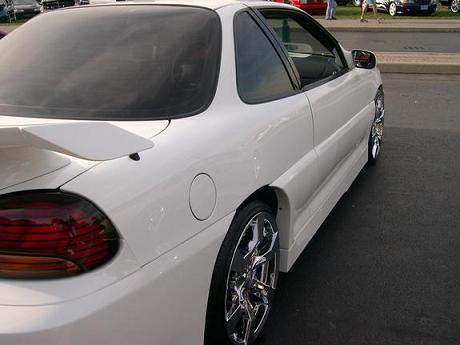

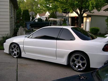

New member Username: Scott_debakerPittsburgh, P.A. U.S.A. Post Number: 3 Registered: Feb-06 | k thankx glass wolf my dad is gonin 2 da place up da road 2 c how much the guy will come 2 da shop an tint my bac window a pro from the inside lol an while hes there ill ask him if he wants 2 make him self money by usin my tit an ill pay him 2 do all the sides i want my windows 2 look like dis gran damns there nice ![]() |
Silver Member Username: B101Queen City, NC USA Post Number: 910 Registered: Sep-05 | now thats a sick tint job, no lie!! grand am looks good with that kit also! |
Bronze Member Username: Scott_debakerPittsburgh, P.A. U.S.A. Post Number: 11 Registered: Feb-06 | ya dats what mine will look liek but black but a diffrent body kit i like that 1 2 its sick but u dont even notive the trim around the windows |
