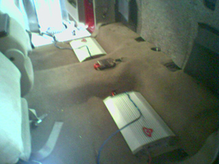

I'm currently running two RE SX 15"s in a 7^3 box tuned to 28hz with two Cerwin Vega Exl 1000ds. I've got a Clarion DXZ855MP h/u but not components yet so pfft on that. I went to a dB drag today and pulled a 145.6 on a TL meter playing 38hz test tone with my amps being turned on only halfway. Should be up around high 150s and possible low 160s after I turn everything up. I was tempted to today but decided it would not be the best thing for the subs until they are broken in :-(.

You're not going to gain 10db+ turning it all the way. You just wont.

Kevin, i kinda hat to burst your bubble...but i highly doubt that your setup will do high 150's.
if you retune your box to ~46-49hz, then yea...i could see you doing mid to high 150s. but w/ a box tuned to 28hz you prolly wont be seeing really high #'s. 145.6 is GREAT for a daily system though. (my 1 SX tuned to 30hz only does ~140 @ 30hz) With a little retuning you should be able to get in the mid150's pretty easily.

yeah, in that enclosure when you give them full power id guess probably a 150. however, yes, with a port tuned higher and a larger port area you could get that 155...

You have 2 1000w amps...right?
If you did 145.6 w/ half power, 1000w...then when you give them 2000wrms, you will see +3dB (in a perfect world)
