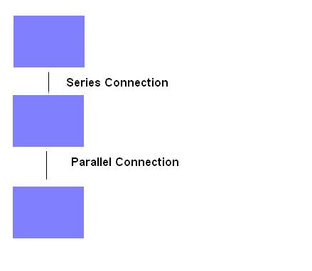

Silver Member Username: FandimReno, Nevada United State... Post Number: 565 Registered: Jun-05 | Tom, that would NOT be a good idea. If you have two subs in series, they're presenting an 8 ohm load, then wire the one in paralell, and then you're presenting a final of 2.67 ohm load. However, the two speakers in series, will only recieve 1/3 of the power, while the single sub wired in parallel to the series connection, will recieve 2/3 of hte power. So if you are using an amp that puts out 300 watts at that impedance... ... and your setup is like this.. Then you're going to end up with this... So it's a bad, bad idea. And it'll sound like crap, too. |

Silver Member Username: B101Queen City, NC USA Post Number: 447 Registered: Sep-05 | ^^ lol like Seth Lowe said, all you will be creating is a Voltage-Divider. You will be giving more power to 1 sub.. They all neeed even amount of power. If you do it, u risk blowing 1 alot faster. |
