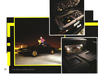

Gold Member Username: Mikechec9Http://www.cardomain.c... Post Number: 1830 Registered: May-05 | cardboard is sweet. that's how we got the molded look of the panels in my hatch. then we just cut the wood from the cardboard's shape. i meant shirts to help mimic the sound of the driver in an enclosure by holding it behind the speaker. of course with the dyn and dls 3", it's not necessary because it's already enclosed. that fish tank enclosure reminds me of dave rivera's buick back in like '92. hence the "fishman" nomer. got pics? |

Gold Member Username: InsearchofbassPost Number: 3897 Registered: Jun-04 | got pics of fishmans stunt???? |
Gold Member Username: Mikechec9Http://www.cardomain.c... Post Number: 1832 Registered: May-05 | it's actually a toyota. amazing how much bigger things looked 15 years ago. small pic ![]() |
Gold Member Username: InsearchofbassPost Number: 3898 Registered: Jun-04 | I just sent you an email to see if I could get those pictures in a larger format thanks, Sean |
