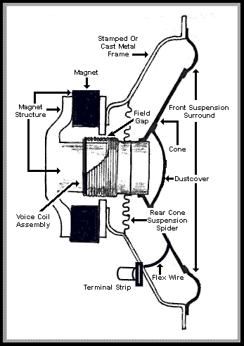

svc means one coil of wire wrapped around the former of the sub. dual means two coils of wire wrapped together around a former. the wire serves as an inductor and receives the power from the amp creating a field of energy which pushes against the static field of the magnet (motor) on the bottom of the sub, thus causing the piston to move.
http://www.adireaudio.com/Files/X_68_Motor_Assy.avi
like taylor said, the difference is just wiring options so that you can run your subs at 2ohms if you choose or 4ohms (or any number of ohms, depending on the configuration and number of subs).
as suggested above, you can review these links for a better concept of a speaker and ohms.
