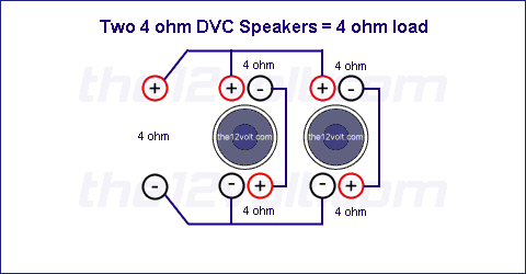

Gold Member Username: RovinTrinidad & T... Post Number: 2742 Registered: Jul-05 | to get the most out of your amp buy 2) 4ohms dvc subs & wire it like this ![]() |

Anonymous | ok, i just wanted to make sure because that link confsed me a little bit. is a 4 ohm load better than a 2 ohm load? right? because it isnt low impedence... |
Gold Member Username: RovinTrinidad & T... Post Number: 2746 Registered: Jul-05 | doesn't matter if a sub is 2ohms 500w or 4 ohms 500w - different VC config are used to match your amp's output/capabilities . From your description just do as i told u above ... |
