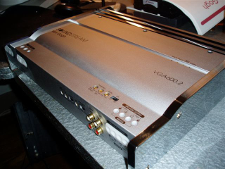

Well mikechec9, you are right on the money concerning the SS Van Gogh amp. I have both the Xtant and the VGA with the covers off and they are so very different. Up close the Xtant appears to be just a few notches down in build quality than the VGA. For instance most of the risitors in the Xtnt have marred color banding and the tin legs are rough with occasipnal imperfections. The Xtants pcb looks thin like maybe only a 2 or 3 layer board. Well it is thinner anyway. There are a few other small differences as well and a few large ones.
Mike I'm worried that I may be in for a long stretch of letdowns if all I have to compare new amps with is this VGa :-) If the Soundstream sounds as good as it looks Im lovin it :-)
I come from a PC o/c'r background and the VGa pcb is just friggen gorgeous. Red with a beautiful layout!

Here is some pics while they are open. It's just not even fair comparing build quality only bewteen the two. Plus just look how sexy the Vga is with clothes on!

i couldn't agree more chino. i recall the first time i saw the amps in a mag listed for way out of my price range. but looked beautiful. then they started popping up on ebay because of the power acoustic buy out. as much as i hate to see ss degrade, it couldn't have come at a better time, lol. great lookers that actually have equal performance.
again, they just run a bit hot because of the relatively small heat sinks, but they don't shut off or distort. i just had the rear air in my truck fixed, so i'm going to be using it as a circulation system for my amps.
