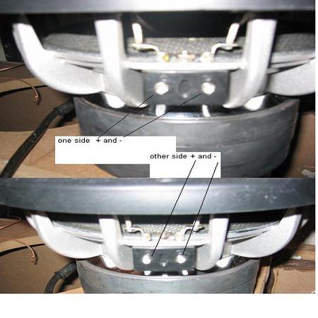

hey guys, just received my 2 re sx. i will be running these 2 sx with orion 2500d amp which will put around 1700 rms.
on each sub , their are 4 + - & + - pannel things. Should i use both positve and both negative , or just from one side.
whats will be the difference if i connect to all of the + - connections on the sub.
here is the picture of what i am talking about.

are they 2ohm or 4 ohm

they are 2 ohms. and 1700 rms will go to both subs. cuz 2500d only gives 1700rms at 2 ohm

1700/2=850 per sub, u can wire them to make a 1 ohm load

i just tried to run them , by putting the neg and pos on one side of the sub and it didnt work. No sound came, just little tick tick happend and thats it :-(
Username: Sinx85
Post Number: 95
Registered: Sep-05
bro i tried but the subs didnt work. i only put + and - to one side of the sub and subs didnt make a sound.
how can i wire them to 1 ohm?
this amp puts 2500 rms at 1 ohm so i guess that will be my best choice. But plz tell me how to do this.
also is this noraml that the subs are not working when i only wire them to 1 of the + - connectors?
thankx

hey bro i just tried one sub first, just to test it, but sub still does not work. All it does is a tick tick tick noice when i hook all the + - terminals. this is how i wired it exactly as it is in this picture below

could it be a short somewhere ?
or
Is your gain turned all the way down ?
