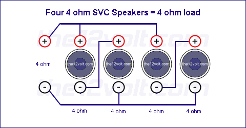

I already have the Alpine on 4 subs (4 ohm load)so they are seeing 700watts from the Alpine. I'm looking for an amp for my comps now and really like the JL 450.4. I'd like to brand match so I was looking at loosing the MRD for the JL 500 which would only be 500watts into 4 Ohms, but it's JL. Would theses 2 amps be comparable inspite of the 200 watt difference? Should I just keep the Alpine? (I know the 1000 would be better but, it cost a bit more and is much harder to fit.)

for which 4 subs ?

4 Polk Momo SVC 4ohm 8s in a ported enclosure.

i figured u have your subs wired @ 4ohms ,right ? - cause that amp is only 2ohms stable & your subs can only be wired like this
that Jl is only 500w which would imo be wasting what your subs can really do .....bottom line keep your Alpine !.............
