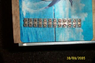

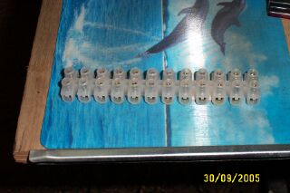

U can splice it as u said - but what i do is get 1 of those terminal strip things Electricians used to join wires with & that works really good too cause it never gets loose .....
Just happen to have 1 nearby so i just now took these pics 4 u ...
