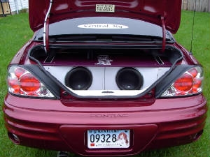

astrosafari7733
Unregistered guest
that looks like a completly different car witht he tailings. the stock tailights on those cars are very easy to notice.
