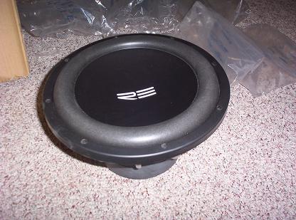

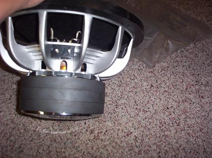

Needing deminsions for a ported box to house 2 12" sxs that will be no longer in width than 31" inches. I need this to fit in the back of my celica.

Planned on only running about 700 max to each cause I can't afford it right now.. and I already have a single 12" SX :P

I got a deal on this sx so an MT/X.X.X would have been out of the question as far as price goes.. Id love to trade my SX with some cash to one of the two if anyone would be interested anyway.
