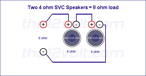

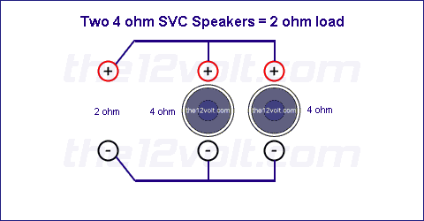

Ok, those are single voice coils at 4 ohms, so you won't be able with 2 of them to get to 4 ohms, the best you can do is 8 or 2 ohms. I will include pics.

Ok those subs together will = 500wrms @ 2ohms
so u pick 1 of these ,a mono amp @ 2ohms
