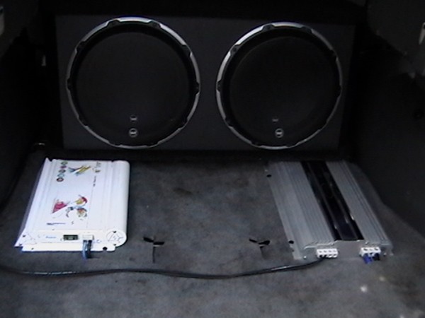

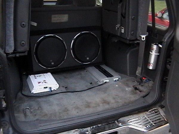

Gold Member Username: Suleman36Maryland U.S.A. Post Number: 2035 Registered: Feb-05 | I found some on sounddomain/cardomain website. Im running 2 amps like i mentioned glasswolf and im gonna have the box built over the amps like that install you did on the 4 Runner. Will i need 2 Fans or will 1 do the job ? Does it get wired to the remote wire and that powers it and and turns it on and off ? Here is my setup for now. I will have the box built over the amps soon. ![]() ![]() |

Silver Member Username: Dz43893Chicago, Illinois United states Post Number: 258 Registered: Jun-05 | MO loves to post a picture of his system! |
Gold Member Username: CarguyPost Number: 3942 Registered: Nov-04 | MO, have you seen the inside of your amps? They're contain lot of TO3 transistors. If I remember, the top of the amp you're looking at is really the bottom of circuit board. The transistors are mounted facing downward. Although the heat from them gets transferred to the amp's chassis, part of it gets trapped between the board and the case. Having a fan aimed at the "half arrow" shaped part of the case will help, but if you can create a vent, it'll help termendously. The same thing applies to your other amp. Test and see if your amps get really hot. If they do, create some vents and install a small fan that sucks the air out. On my HCCA G4 amps, they have fins, but yours hardly does. What I have done in the past with chassis like that was to install extra heat sinks with larger fins and bolt or weld onto the amp. It cools down the much faster. If you really wanted to get nerdy, youl could purchase a heat monitoring kit that's used in computer cases and hook that up to your amps. Then you can set the temperature to whatever you wanted and it'll kick start the fans. |

Gold Member Username: CarguyPost Number: 3968 Registered: Nov-04 | MO, does your amp shut down from overheating? My Orion amps so far hasn't (knock on wood). I don't see the point in installing them without testing. My PPI Art series amp gets warm to med hot. Your amp will probably do the same. It is natural for the amp to play warm. |
Gold Member Username: Suleman36Maryland U.S.A. Post Number: 2057 Registered: Feb-05 | My amps havent shut down on me yet and its been hot as hell this the last 2 weeks ive had my system in my car. |
Gold Member Username: GlasswolfWisteria, Lane USA Post Number: 9492 Registered: Dec-03 | never hurts to cool the amps anyway. the cooler you keep them, the lower you keep distortion. as long as the amps are in a location where fan noise isn't an issue, I always prefer to cool fans externally to be safe. one fan per amp should be plenty. fan is 8-1/2" x 1-1/4" x 1-1/4" http://www.pac-audio.com/products/fans.htm first one listed |
